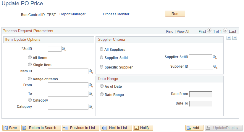

Access the Price Update page.
Use the page controls to select criteria for the price updates.

Use the Update PO Price page (RUN_PO_PRICE_UPD) to run the Price Update application engine process (PO_PRICE_UPD) to scan the Item/supplier UOM tables to locate item/supplier prices that have become effective and calculate the item's new standard price or business unit standard price based on the item/supplier UOM price.
Navigation:
This example illustrates the fields and controls on the Update PO Price page. You can find definitions for the fields and controls later on this page.
You can use the filter controls on this page to limit the prices to be updated.
Date Range
Field or Control |
Description |
As of Date |
Select to process prices that are currently effective. |
Date Range |
Select to process prices that are in effect within the range that you specify in the Date From/Date To fields. |
