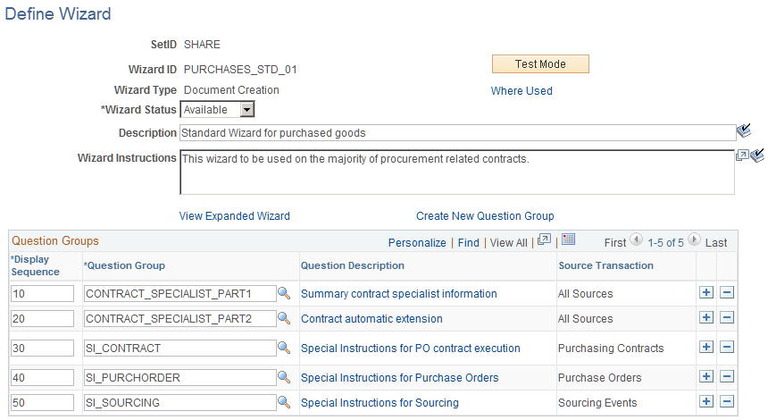

Use the Define Wizard page (CS_WIZARD_SUMM) to add or maintain a document creation or configurator selection wizard.
Navigation:
This example illustrates the fields and controls on the Define Wizard page.
You can use this page to add or maintain a document creation or configurator selection wizard. When you add a wizard, the Copy From button is available for you to locate and copy an existing wizard. When you maintain a wizard, the Test Mode button is available to test the wizard flow.
The same bind variable cannot be used in a Question Group of Source Transaction type of All and a specific Source Transaction type on the same wizard.
Field or Control |
Description |
Wizard ID |
Displays the system identifier for this wizard. When the wizard is available for use, you can select it from the wizard ID list when you create or maintain a document configurator. |
Copy From |
Click to access the Copy Wizard Definition page. You use the page to search for other wizard IDs that might be similar to the type of document requirement you have. The search is within the current SetID. When you save the current question group, the Copy From button is no longer available and is replaced by the Delete button. After you use the wizard in a document, the Delete button also becomes unavailable. |
Test Mode |
Click to access either the Test-Document Creation Wizard or the Test-Configurator Selection Wizard page, where you can review and verify the question flow used with the wizard. This button is available after the wizard is saved. See Test-Configurator Selection Wizard Page. |
Wizard Type |
Displays the type of wizard the system will create. You select this value when you add the wizard, and it determines the use of the wizard. Values are:
Source Transaction |
Select a source transaction type on which to base the use of this wizard. This field is available when you select the Configuration Selection value in the Wizard Type field. When you select the source transaction, the system limits the use of the wizard to that transaction type. Values include: Ad Hoc, Purchasing Contracts, Purchase Orders, and Sourcing Events. |
Wizard Status |
Select a value to indicate the state of the wizard. The status determines if the wizard is available for use throughout the system or is still in a draft mode. The Available value means that you can use the wizard to create documents, and the wizard will appear in lists of values for wizards. If you select Draft, the wizard cannot be used to create documents and does not appear with available wizards. |
Where Used |
Click to access the Search for All Content Instances page, where you can view where this wizard is used. |
Description |
Enter a value that uniquely describes the wizard. |
Wizard Instructions |
Enter any information that you want to provide with the wizard. The information should relate to the purpose of the wizard and any requirements for its use in creating a document. |
View Expanded Wizard |
Click this link to access the Wizard Summary page. Use this page to view all aspects of the wizard, including its questions, sequence, and navigation routes. You can also download the information to a Microsoft Excel spreadsheet. |
Create New Question Group |
Click to access the Question Groups Page, where you can define another set of questions for this wizard. The system provides a new page for this function. |
Display Sequence |
Enter the order in which the system should use a question group. When you use the wizard to create a document, the Wizard Execution routine asks the questions contained in the group in the sequence you define, beginning with the lowest number. |
Question Group |
Select a group of questions that you want to use in this wizard definition. You can define multiple groups and execute them in any sequence you define. Available question groups are determined by the wizard type you select. |
Question Description |
Click to view the questions contained in this question group. Along with the questions, you can view yes and no navigation details and the bind variables. You use this link to verify that you selected the correct question group. |
