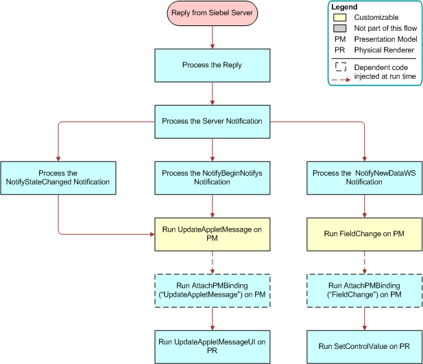

Flow That Sends a Notification State Change
The following figure illustrates the life cycle flow that Siebel Open UI follows to send a notification state change. The steps in the flow, after the user clicks the New button, are as follows:
  1. Process the reply.
  2. Process the server notification.
    • Process the NotifyStateChanged notification, then go to step 3.
    • Process the NotifyBeginNotifys notification, then go to step 3.
    • Process the NotifyNewDataWS notification, then go to step 4.
  3. Run UpdateAppletMessage on Presentation Model (PM).
    • Run AttachPMBinding ("UpdateAppletMessage") on PM.
    • Run UpdateAppletMessageUI on PR.
  4. Run FieldChange on PM.
    • Run AttachPMBinding ("FieldChange") on PM.
    • Run SetcontrolValue on PR.
For more information about the notifications that this flow describes, see Notifications That Siebel Open UI Supports.
Flow That Sends a Notification State Change: This image is described in the surrounding text.
