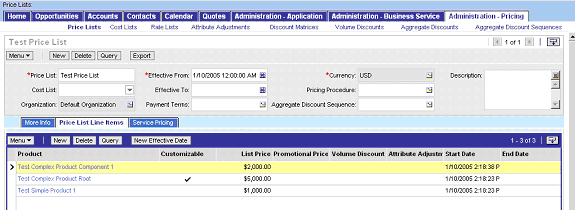

A simple product and a complex product with a component product are created. A price list is then created and the products are associated with it, as shown in the following figure.
This figure shows the Administration — Pricing tab in the Price Lists view. Two complex products and a simple product are listed in the Price List Line Items pane.
