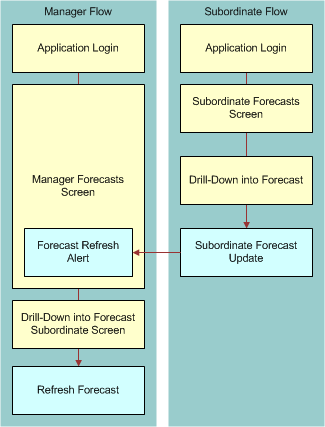

The refresh process flow is summarized in the following image:
  1. A subordinate logs into the application, navigates to the Subordinate forecasts view, drills down into a forecast, and updates the forecast.
  2. When the subordinate is finished updating the forecast, the subordinate’s manager receives a forecast Refresh Alert.
  3. The subordinate’s manager drills down into Subordinate forecasts view, and refreshes the forecast.
Refresh Process Flow: This image is described in the surrounding text.
