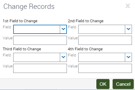

The following image shows an example of the change records dialog box.
Example of the Change Records Dialog Box. This image contains the following options: 1st Field to Change, 2nd Field to Change, 3rd Field to Change, 4th Field to Change. Each of these options contains a Field drop-down list and a Value input field. There is an OK and a Cancel button.

  3. Click Menu (the cogwheel icon), and then click Change Records.
    The Change Records dialog box appears.
    In the drop-down lists for the fields in this dialog box (1st Field, 2nd Field, 3rd Field, and 4th Field to Change), columns on the list applet appear, except for those columns that are marked Inactive or Read Only. List columns do not appear if they are based on a join field and pick applets are not associated with them.
    Note: Be careful when updating the value for a Multi-Value Group (MVG) field. When you update the value for such a field, you not only update the field value for the records you select in step 2, but in all records in the application that contain the same field value.
  4. From the 1st Field to Change drop-down list, select the field in which you want to change data.
  5. Enter the new data in the corresponding Value field.
    Repeat step 4 and step 5 until you enter all of the information you want to change in your selected records.
  6. Click OK to apply the changes.
