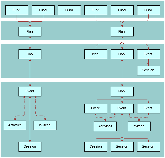

The following image shows the possible relationships between MedEd funds, plans (primary and subplans) events, sessions, activities, and invitees:
Funds are made up of Plans.
Plans are made up of Events or subplans; subplans in turn are made up of events.
Events are made up of Sessions, Activities, and Invitiees.
