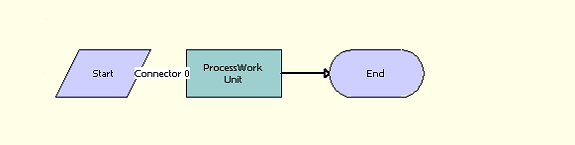

The LOY Bulk Member Admin Process workflow, shown in the following image, is called in asynchronous mode for each work unit used in bulk member administration. For more information about work units, see About Bulk Loyalty Membership Administration.
Workflow Description. This workflow performs the following action:
ProcessWorkUnit. This step calls the ProcessWorkUnit method of the LOY Member Admin Service business service, which processes the subset of member administration records that is passed to the workflow by the LOY Member Admin Integration Object.
