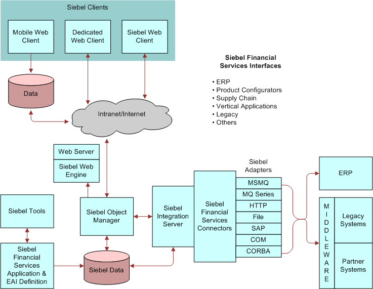

The following image illustrates available Siebel Financial Services interfaces.
