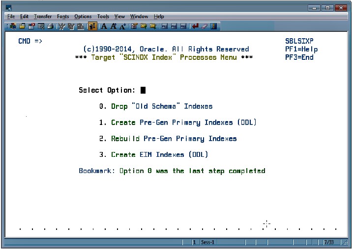

    The Target SCINDX Index Processes Menu is displayed. The panel ID is SBLSIXP.
    The Target SCINDX Index Processes Menu options are: 0. Drop Old Schema Indexes, 1. Create Pre-Gen Primary Indexes (DDL), 2. Rebuild Pre-Gen Primary Indexes, 3. Create EIM Indexes (DDL).
