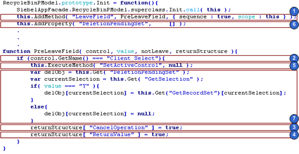

In this topic, you modify the list column control that you created in Step 3. This control uses a check box, so you must make sure that Siebel Open UI stores the value of this check box when the user toggles it.
The following figure illustrates the code that you use to customize the presentation model logic to identify the records to delete. Each number in this figure identifies the corresponding step number in the numbered task list that this book includes immediately after this figure.
Customizing the Presentation Model Logic to Identify the Records to Delete: This image is described in the surrounding text.

  1. In the recyclebinpmodel.js file, add the method that Siebel Open UI must call:
    this.AddMethod("LeaveField", PreLeaveField, {sequence:true, scope:this});

  2. Create the condition:
    if (ctrl.GetName() === "Client_Select"){

  3. Make sure Siebel Open UI returns your custom logic after it sets the CancelOperation part of the return value to true:
    returnStructure[ "CancelOperation" ] = true;

  4. Configure Siebel Open UI to return a value of true after it sets the CancelOperation part of returnStructure to true:
    returnStructure[ "ReturnValue" ] = true;

  5. Disable the processing that Siebel Open UI does for the control that is in focus:
    this.ExecuteMethod("SetActiveControl", null);

  6. Add the property that Siebel Open UI uses to store the set of records that are pending deletion:
    this.AddProperty("DeletionPendingSet", []);

  7. Identify the records that Siebel Open UI must delete:
    var delObj = this.Get("DeletionPendingSet");
    var currentSelection = this.Get("GetSelection");
    if(value === "Y"){
      delObj[currentSelection] = this.Get("GetRecordSet")[currentSelection];
    else{
      delObj[currentSelection] = null;
    Siebel Open UI must identify the records that the user chooses to delete so that it can populate a value into the DeletionPendingSet property. To identify this property, you can examine the properties that the presentation model uses for the applet. This work is similar to the work you do in Step 1 to identify the property in the presentation model that Siebel Open UI uses for lists, except in this topic you examine the properties described in Properties of the Presentation Model That Siebel Open UI Uses for List Applets.
    After examining these properties, assume you determine that Siebel Open UI uses the GetSelection property to get the index of the record that the user has chosen from among all the records that Siebel Open UI displays. You also determine that you can use the GetRecordSet property to get this full set of records.
