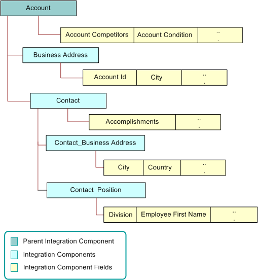

Each child component can have one or more child components. In Siebel Tools, if you look at the integration components for an integration object you have created, then you see that each component can have one or more fields. The following figure illustrates a partial view of a Siebel integration object based on the Account business object, with the Business Address component and the Contact component activated.
The following figure represents part of the structure of the Account integration object. The Account parent integration component can have both fields and child integration components. Each integration component can also have child integration components and fields. A structure of this sort represents the metadata of an Account integration object. You can choose to inactivate components and fields. By inactivating components and fields, you can define the structure of the integration object instances entering or leaving the system.
Partial Representation of Account Integration Object. In this image, there is a Parent Integration Component (Account) which has the following Integration Components: Business Address, Contact, Contact_Business Address, and Contact_Position. The Parent Integration Component and the Integration Components each have Integration Component Fields.
