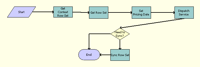

The following figure shows the PSP Driver Workflow Process, which is a generic example of a controller workflow. PSP Driver Workflow Process uses variable maps to retrieve data that is then synchronized back to the database.
PSP Driver Workflow Process. This image is described in surrounding text.
As shown in the previous figure, the PSP Driver Workflow Process steps perform as follows:
  • Get Context Row Set. Calls the Context Service business service method GetRowSetData to retrieve header-level information using the Context variable map (Variable Map - Context).
  • Get Row Set. Calls the Context Service business service method GetRowSetData to retrieve row-level information using the Row Set variable map (Variable Map - Row Set) and to scope input arguments.
  • Dispatch Service. Calls the sub workflow process defined in the calling signal and passes in the input argument.
  • Set Pricing Date. Sets pricing date based on whether it is for scenario testing:
    • Set system time stamp if it is not for scenario testing:
      {Context.Effective Pricing Date} = TimeStamp()
    • Set Active JWS Test DT if it is for scenario testing:
      {Context.Effective Pricing Date} = GetProfileAttr("Active JWS Test DT")
  • Sync Row Set. Calls the Context Service business service method SyncRowSetData to write any updates back to the database (for example, updates to prices).
