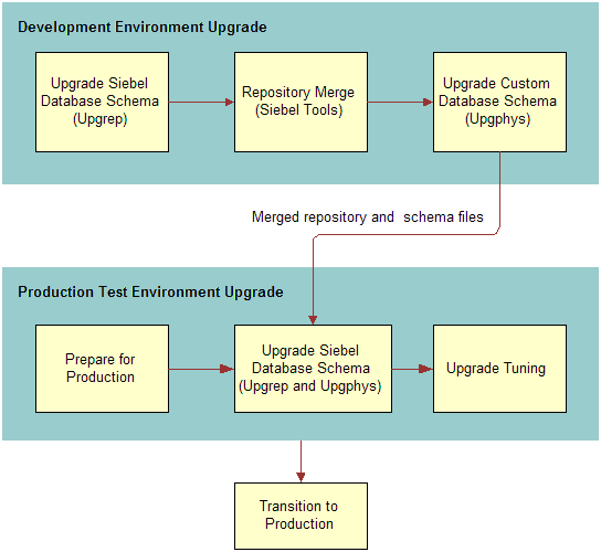

The following image shows how the Database Configuration Wizard (and Upgrade Wizard) work together with the Siebel Tools repository merge to upgrade your environments. The steps shown in the following image are as follows:
Development Environment Upgrade:
Upgrade Siebel database schema (Upgrep)
Repository merge (Siebel Tools)
Upgrade custom database schema (Upgphys)
Merged repository and schema files from development environment are sent to production test environment.
Production Test Environment Upgrade:
Prepare for production
Upgrade Siebel database schema (Upgrep and Upgphys)
Upgrade tuning.
Transition to Production.
