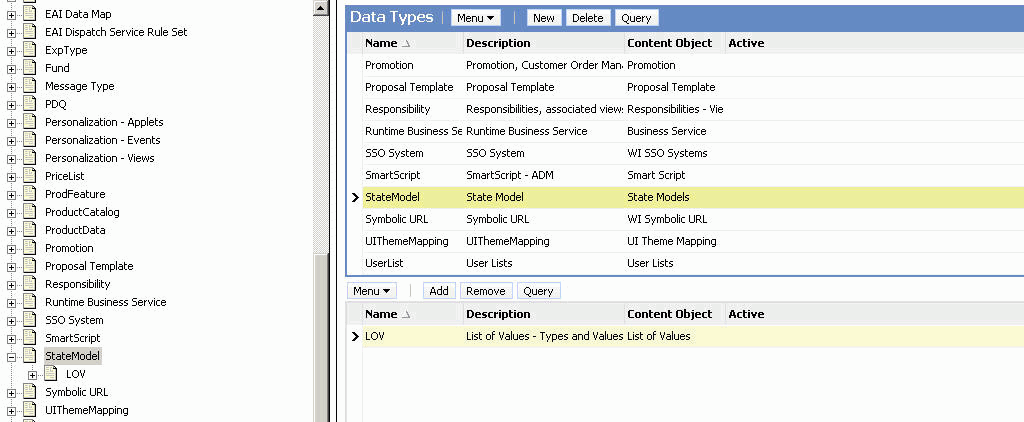

The following image shows an example of creating an ADM data type child relationship between State Model (parent) and LOV (child) data types.

     Navigate to the Application Deployment Manager screen, then the Data Type Explorer view.
     In the Data Types list or Data Type explorer list, select the data type of interest.
     Click the Add button to access the data type list.
     Select the child data type of interest from this list. The selected child data type appears under the parent data type in the Data Type Explorer view.
To remove a child relationship from an ADM data type
     In the child data type list, select the child data type that you want to remove, and click the Remove button.
