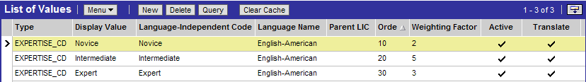

  3. For each of the resulting display values (default values are Novice, Intermediate, and Expert), click in the Weighting Factor field and enter a numerical value.
    The numerical value that you enter in this field, relative to the maximum weighting value defined, represents the percentage applied to the skill score.
    Tip: If the Weighting Factor field might be a hidden column in this list. You can use the Columns Displayed feature to make fields visible. For more information, see Siebel Fundamentals Guide.
The following figure shows an example of defining the weighting factors for the default expertise codes (novice, intermediate, expert) using the values (2, 5, 3) listed in the previous table.
Example of Defining Weighting Factors: In this image, the Weighting Factor value is 2 and the Order value is 10 for Novice. For Intermediate, the Weighting Factor value is 5 and the Order value is 20. For Expert, the Weighting Factor value is 3 and the Order value is 30. The Active and Translate check boxes are selected for each record.
