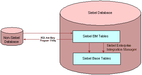

The following image illustrates the process flow between a non-Siebel database and Siebel EIM database as follows:
  • A non-Siebel database uses an SQL ancillary program utility to receive or send data to Siebel EIM tables.
  • Siebel EIM moves data between Siebel EIM tables and Siebel base tables.
Process Flows Between Siebel Database and Other Databases: This image is described in the surrounding text.
