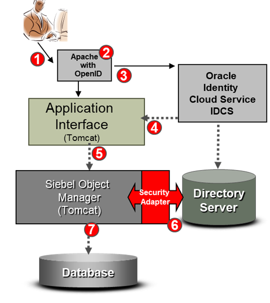

The following figure describes the architecture for Siebel CRM 2018 integration with IDCS.
The Siebel CRM 2018 integration with IDCS architecture has this workflow:
- User tries to access Siebel URL protected by Apache HTTP Server 2.x.
- The Apache reverse proxy with Open ID module intercepts the request (HTTPS / HTTP).
- OpenID checks for the existence of a session cookie on the user’s computer. If a valid cookie exists, then the OpenID populates the header variable and the UserID is passed to Siebel.
- If no cookie exists, then the user is prompted for credentials using the IDCS form. The user enters the credentials which are passed to the Identity Cloud Service.
- If the credentials are authenticated, then the IDCS session cookie is set and the OpenID sets the header variable and redirects the request to Siebel.
- Siebel security adapter retrieves the database account and role information from the directory server.
- Siebel session is started with the appropriate responsibilities and shows the information based on user’s position.
