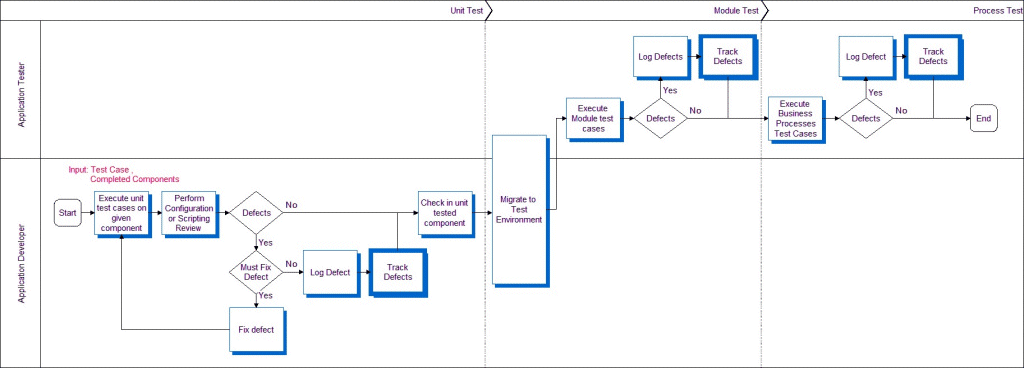

The following image illustrates the process of executing Siebel functional tests.
Execute Siebel Functional Tests Process
As shown in this image, there are three phases in the process of executing Siebel functional tests:
  1. Unit test. The unit test validates the functionality of a single component (for example, an applet or a business service). Typical steps involved in unit testing include the following:
    1. Execute unit test cases on a given (completed) component.
    2. Perform configuration or scripting review.
    3. Regarding defects:
      • Fix critical defects that must be fixed, and return to step a.
      • Log and track other defects, if there are any, and continue to step d.
    4. Check in unit tested component.
  2. Module test. The module test validates the functionality of a set of related components that make up a module (for example, Contacts or Activities). Typical steps involved in module testing include the following:
    1. Migrate the (unit tested) component to a Test environment.
    2. Execute module test cases on the component.
    3. Log and track defects if there are any.
  3. Process test. The process test validates that multiple modules can work together to enable a business process (for example, Opportunity Management or Quote to Order). Typical steps involved in module testing include the following:
    1. Execute business process test cases on the component.
    2. Log and track defects if there are any.
