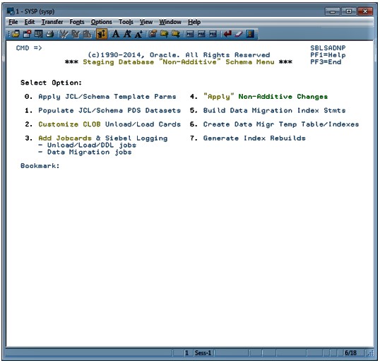

On the Staging Database File Generation Menu, select option 5: Process Non-Additive Components, and press Enter.
The Staging Database Non-Additive Schema Menu is displayed. The panel ID is SBLSADNP.
On the Staging Database Non-Additive Schema Menu, select option 0: Apply JCL/Schema Template Parms, and press Enter.
If you are performing a production environment upgrade, you are prompted to confirm that you have applied all planned additive changes to the staging database. Enter Y and press Enter.
Messages are displayed indicating that changes are being applied to the Unload and Load data sets.
On the Staging Database Non-Additive Schema Menu, select option 1: Populate JCL/Schema PDS Datasets, and press Enter.
Submit the JCL in data set
DSNHLQ.SIEBEL.INSTALL.JCL(UNPACK02).This job unpacks the JCL and schema files into members in their corresponding PDS data set.
After submitting the job, verify that the job ran successfully with a return code of 0. For information, see Verifying JCL Upgrade Jobs.
On the Staging Database Non-Additive Schema Menu, select option 2: Customize CLOB Unload/Load cards, and press Enter.
