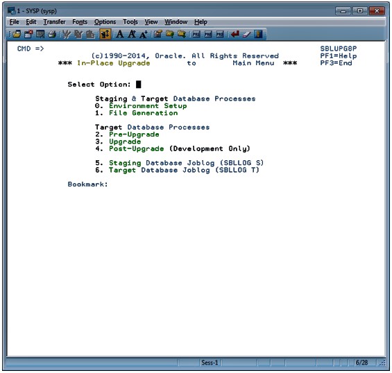

Use the following command to display the Siebel In-Place Upgrade Main Menu:
EXEC 'DSNHLQ.SIEBEL.EXEC'The Main Menu is displayed. The panel ID is SBLUPG8P.
On the Siebel Upgrade Main Menu, select option 0: Environment Setup, and press Enter.
