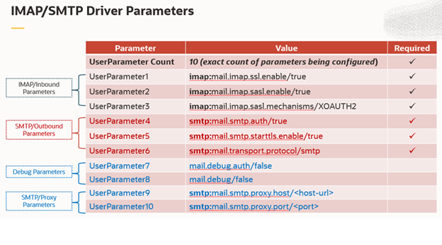

      Refer to the table below to configure profile parameters for IMAP/SMTP driver:
      Parameters for IMAP/SMTP driver
      This table shows you the complete list for the IMAP/SMTP Driver Parameters related to OAuth enablement. Some of the parameters are required, some of them are optional.
      UserParameter Count: It shows the exact count of the parameters being configured. For example, if you only need to configure 8 parameters, put ‘8’ as the value for this parameter.
      UserParameter 1-3: these parameters are related to the IMAP/inbound protocol. If you have previously configured the parameters to enable OAuth for your IMAP protocol, we highly recommend that you add “imap” prefix to these parameters to ensure they are adaptable to future changes.
      UserParameter 4-6: these parameters are related to the SMTP/outbound protocol. Make sure you add “smtp” prefix to the values.
      • smtp:mail.smtp.auth/true - enables SMTP authentication in Java mail which is required to user OAuth
      • smtp:mail.smtp.starttls.enable/true - required as the SMTP server expects the communications it secures to be secure/encrypted.
      • smtp:mail.transport.protocol/smtp - sets the default transport method for outbound emails to be smtp
      UserParameter7-8: these two parameters are used to turn on logs. The default settings are False. If you need to troubleshoot issues related to OAuth authentication process, you can turn on logs using these parameters.
      UserParameter9-10: some customers may want to set up SMTP Proxy server. An SMTP Proxy server acts as an intermediary between an email client (or server) and the SMTP server used to send emails. Instead of directly sending an email from the client to the SMTP server, the email first passes through the SMTP Proxy server. It can enhance the performance, security, and reliability of email communications. You can configure these two parameters if you have SMTP Proxy server setup.

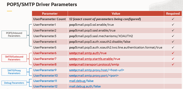

      This table shows the parameter list for the POP3/SMTP Driver related to OAuth enablement. Some of these parameters are required, some of them are optional.
      UserParameter Count: it shows the exact count of the parameters being configured.
      POP3/Inbound UserParameters: it is highly recommended that you add “pop3” prefix to these parameters to ensure they are adaptable to future changes.
      Regarding parameters for the SMTP/outbound protocol, make sure you put “smtp” prefix to the values.
      If you need to troubleshoot issues related to OAuth authentication process, you can turn on logs using the mail.debug parameters. They are optional parameters.
      Some customers may want to set up SMTP Proxy server. An SMTP Proxy server acts as an intermediary between an email client (or server) and the SMTP server used to send emails. Instead of directly sending an email from the client to the SMTP server, the email first passes through the SMTP Proxy server. It can enhance the performance, security, and reliability of email communications. You can configure these two parameters if you have SMTP Proxy server setup.
