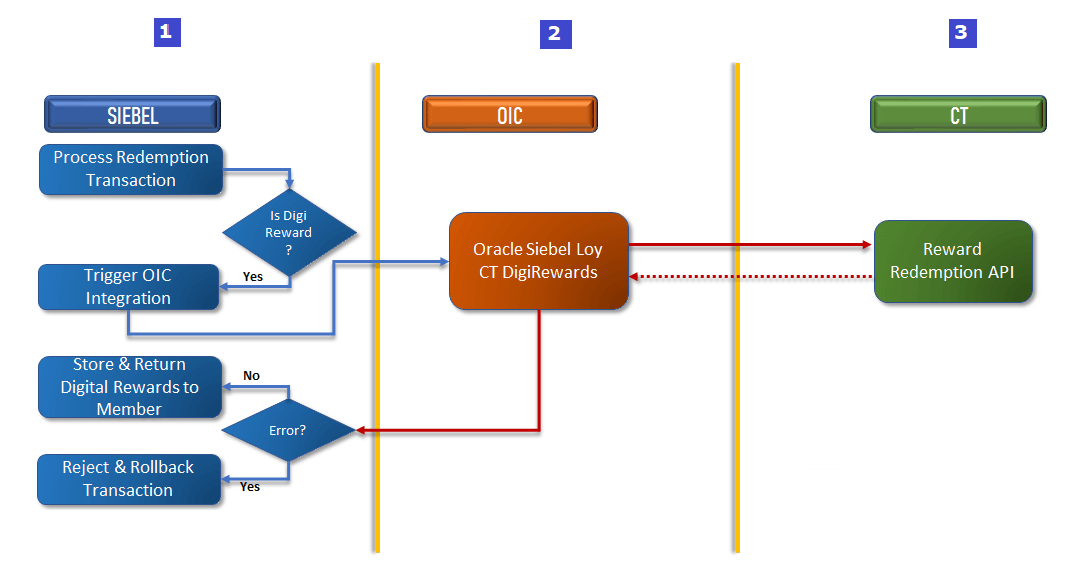

As illustrated in the following image, the typical steps involved in the Reward Redemption (real-time) flow from Siebel Loyalty to CrowdTwist are as follows:
                    The Siebel Loyalty transaction processing engine redeems the points for any Digital Reward (Sweepstake, Digital Download, or DigiCode) and then triggers OIC integration through the synchronous REST service. If successful, the digital reward details are stored at the transaction level and returned to the member. In case of error, the redemption transaction is rejected, and the redemption of the points is rolled back.
                    OIC integration (Oracle Siebel LOY CT DigiRewards) looks up the CrowdTwist RewardId corresponding to the Siebel Product Id. It then invokes the CrowdTwist Reward Redemption API to get the requested reward details. Details of any errors are returned to Siebel Loyalty.
                    CrowdTwist redeems the reward and sends back the Digital Code (in the case of DigiCode), Downloadable URL (in the case of Digital Download) or enroll (in the case of Sweepstake).
