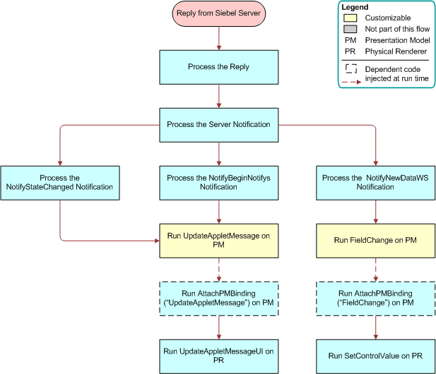

The following figure illustrates the life cycle flow that Siebel Open UI follows to send a notification state change. The steps in the flow, after the user clicks the New button, are as follows:
Process the reply.
Process the server notification.
Process the NotifyStateChanged notification, then go to step 3.
Process the NotifyBeginNotifys notification, then go to step 3.
Process the NotifyNewDataWS notification, then go to step 4.
Run UpdateAppletMessage on Presentation Model (PM).
Run AttachPMBinding ("UpdateAppletMessage") on PM.
Run UpdateAppletMessageUI on PR.
Run FieldChange on PM.
Run AttachPMBinding ("FieldChange") on PM.
Run SetcontrolValue on PR.
For more information about the notifications that this flow describes, see Notifications That Siebel Open UI Supports.
