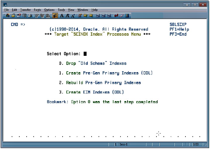

The Target SCINDX Index Processes Menu is displayed. The panel ID is SBLSIXP.
Select option 0: Drop Old Schema Indexes, and press Enter.

On the Target SCINDX Index Processes Menu, select option 1: Create Pre-Gen Primary Indexes (DDL), and press Enter.

On the Target SCINDX Index Processes Menu, select option 2: Rebuild Pre-Gen Primary Indexes (DDL), and press Enter. This job rebuilds the Pre-Gen primary indexes to create ROW_IDs for the data in the existing row.

On the Target SCINDX Index Processes Menu, select option 3: Create EIM Indexes (DDL), and press Enter.
