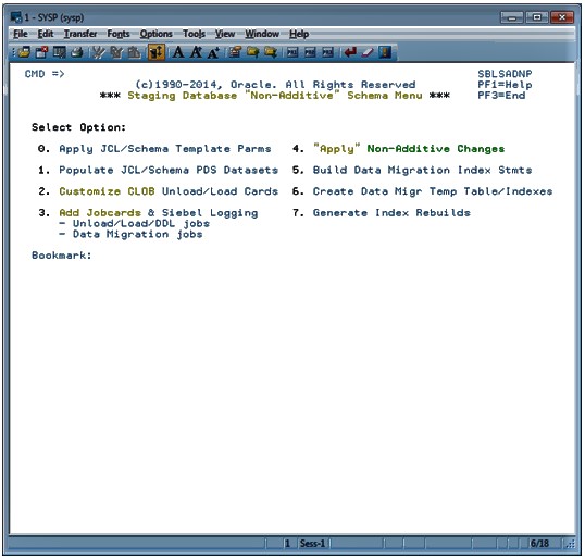

  1. On the Staging Database File Generation Menu, select option 5: Process Non-Additive Components, and press Enter.
    The Staging Database Non-Additive Schema Menu is displayed. The panel ID is SBLSADNP.
    The Staging Database Non-Additive Schema Menu options are: 0. Apply JCL/Schema Template Parms, 1. Populate JCL/Schema PDS Datasets, Customize CLOB Unload/Load Card, 3. Add Jobcards and Siebel Logging (Unload/Load/DDL jobs, Data Migration jobs), 4. Apply Non-Additive Changes, Build Data Migration Index Stmts, 6. Create Data Migr Temp Table/Indexes, Generate Index Rebuilds.
