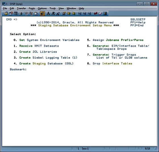

    The Staging Database Environment Setup Menu is displayed. The panel ID is SBLSSETP. The options on this panel allow you to prepare files and set environment variables to create the staging database.
    The Staging Database Environment Setup Menu options are: 0. Set System Environment Variables, 1. Receive XMIT Datasets, 2. Create JCL Libraries, 3. Create Siebel Logging Table (1), 4. Create Staging Database (DDL), 5. Assign Jobname Prefix/Params, 5. Generate: EIM/Interface Table/Tablespace Drops, 6. Generate: Trigger Drops List of Tbl w/ CLOB columns, 8. Drop Interface Tables.
