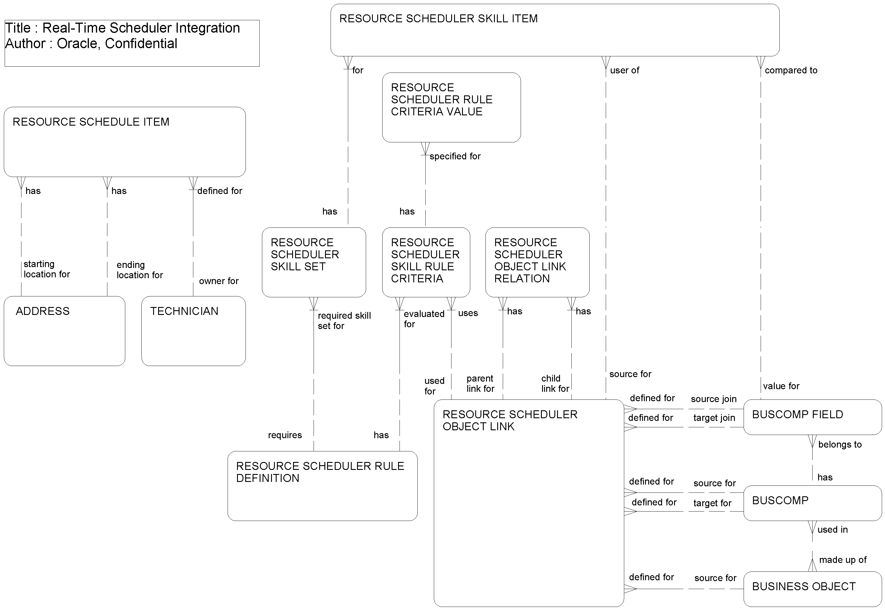

Real-Time Scheduler Integration
In a typical field service scenario, technicians are sent to a customer's location to do a job such as performing an installation, upgrade, or repair. Real-Time Scheduler is an external application that performs the scheduling ERD (see the following figure for an example). Scheduling involves matching an available service technician with a job or service request. Each job includes a set of necessary skills. For example, installation of a set-top box might require a skill, such as training in electrical wiring. Each technician has a distinct set of skills. The job of the scheduler is to find the best technician who is available and has the necessary skills to perform the job.
The following information is mastered and stored in the Siebel application:
Technician details (name, phone number, and so on.)
Technician schedule and availability
Technician skill set
Job details
Job skills (skills required to accomplish the job)
Service requests for jobs
Real-Time Scheduler can use this information to prepare a schedule that contains a timetable for each technician. To enable this, the Siebel application must use the Real-Time Scheduler Web service to pass the skills needed to do the job to the Real-Time Scheduler.
The following table lists the entities in this ERD and their corresponding tables.
| Entity | Table |
Address |
S_ADDR_PER |
Buscomp |
S_BUSCOMP |
Buscomp Field |
S_FIELD |
Business Object |
S_BUSOBJ |
Resource Scheduler Rule Criteria Value |
S_RS_CRIT_VAL |
Resource Scheduler Object Link |
S_RS_OBJ_LNK |
Resource Scheduler Object Link Relation |
S_RS_OBJLNK_REL |
Resource Scheduler Skill Rule Criteria |
S_RS_RULE_CRIT |
Resource Scheduler Rule Definition |
S_RS_RULE_DEF |
Resource Schedule Item |
S_RS_SCHD_EVENT |
Resource Scheduler Skill Item |
S_RS_SKILL_ITM |
Resource Scheduler Skill Set |
S_RS_SKILL_SET |
Technician |
S_USER |
