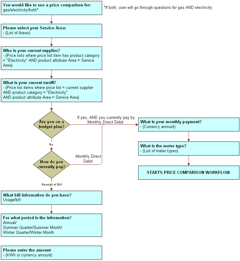

The following image shows the SmartScript text for the Price Comparison feature.
SmartScript Workflow for Price Comparison: Described in the surrounding text.
The transcript of the SmartScript text in the previous image follows:
You would like to see a price comarision for:
 - gas/electricity/both
   (if  both, user will go through questions for gas AND electricity)
Please select your Service Area:
 - (List of Areas)
Who is your current supplier?
- (Price lists where price list item has
   product category = "Electricity" AND
   product attribute Area = Service Area)
What is your current tariff?
- (Price list items where
   price list = current suspplier AND
   product atribute Area = Service Area)
Are you on a budget plan?
If YES, AND you currently pay by monthly direct debit:
 - What is your monthly payment?  - (Current amount)
 - What is the meter type?  - (List of meter types)
 - STARTS PRICE COMPARISON WORKFLOW
If NO, how do you currently pay?
If you currently pay by monthly direct debit:
 - What is your monthly payment?  - (Currency amount)
If you pay by receipt of bill:
 - What bill information do you have?  (Usage/bill)
 - For what period is the information?  (Annual/Summer Quarter/Summer Month/Winter Quarter/Winter Month)
 - Please ener the amount  (KWh or curency amount)
