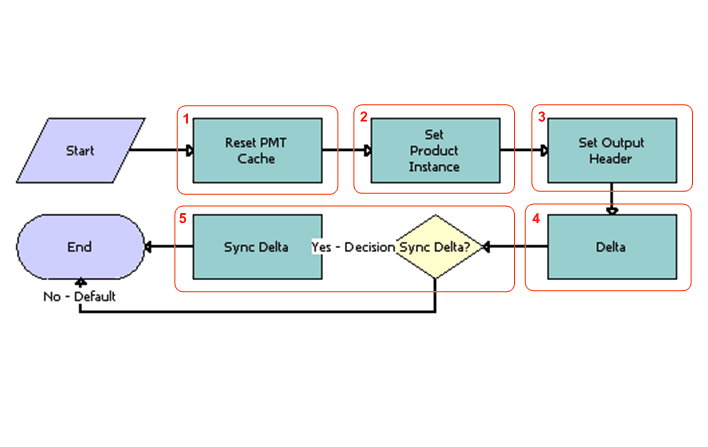

This workflow, shown in the following figure, is called by the Headless Configuration Service to synchronize the changes to the customizable product line item. The asset based ordering difference between the batch validated asset and the original asset is calculated, and that is applied to the document.
This workflow is called by the HdlsCfgSvcSyncABO signal.
SIS OM Sync Delta Subprocess. This image is described in surrounding text.
Workflow Description
This workflow does the following:
  1. Reset PMT Cache. This step resets the cache to prevent an incomplete workflow from entering the PMT cache.
  2. Set Product Instance. This step sets the product instance.
  3. Set Output Header. This step sets the output header.
  4. Delta. This step calls the Delta method of the SIS OM PMT Service to compare the modified asset against the original asset.
  5. Sync Delta? This step checks if the decision is to synchronize the change:
    • If the decision to synchronize is Yes, then synchronizes the change.
      This decision is controlled by the Sync input argument of the Headless Configuration Service business service.
    • If the decision to synchronize is No (which is the default), then the process ends.
