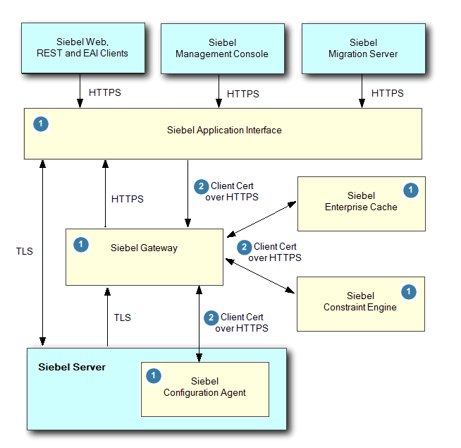

Siebel installer for Siebel Business Applications enforces HTTPS during installation, as follows:
Siebel Web Clients, Siebel Management Console and the Siebel Migration server all communicate with the Siebel Application Interface over HTTPS.
All communication between Siebel services (Siebel Application Interface, Siebel Gateway, and Siebel Configuration Agent) are enforced over HTTPS by Siebel installer.
Siebel Application Interface is an external interface accessing Siebel services. All other Siebel services are internal services and they are protected by client certificate based authentication.
Any Siebel service-to-service access is over HTTPS with client certificate based authentication (for example, two-way SSL). Client certificates are used for service-to-service authentication.
The following figure illustrates the certificate requirements for communications as follows:
Siebel Application Interface, Siebel Gateway, and Siebel Configuration Agent are hosted in application containers (Apache Tomcat).
