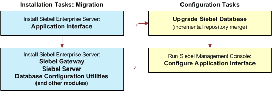

The following figure presents a simplified view of the installation and configuration tasks for Siebel CRM server modules for a migration deployment, which are as follows:
Installation Tasks: Migration. Install Siebel Enterprise Server and the following components: Siebel Application Interface, Siebel Gateway, Siebel Server, Database Configuration Utilities (and other modules).
Configuration Tasks. Upgrade Siebel Database (incremental repository merge). Run Siebel Management Console and Siebel Application Interface.
