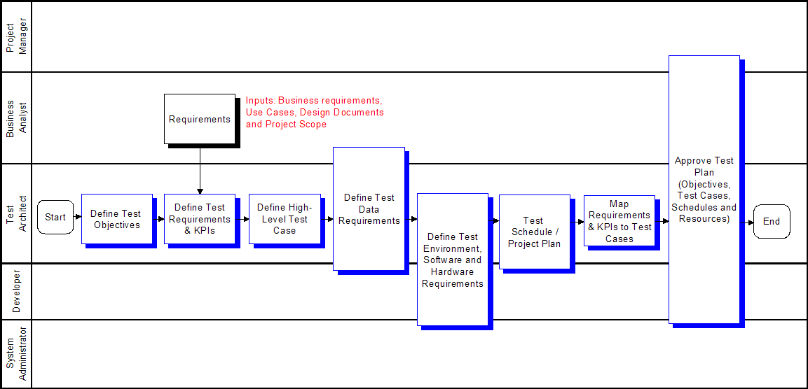

The objective of the test planning process is to create the strategy and tactics that provide the proper level of test coverage for your project. The following image illustrates one example of the test planning process.
As shown in this image:
The inputs to the test planning process are the business requirements and the project scope.
The outputs or deliverables for the test planning process include the following:
