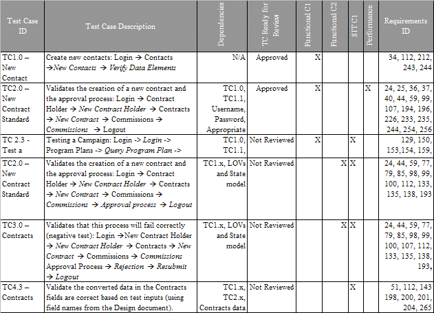

A test case represents an application behavior that needs to be verified. For each component, application, and business process you can identify one or more test cases that need verification. The following image shows an example of a test case list. Test plans typically contain multiple test cases.
The example shown in this image uses the following numbering schema for the Test Case ID:
TC1.x – New records and seed data required to support other test cases
TC2.x – Positive test cases
TC3.x – Negative test cases
TC4.x – Data Conversion testing
TC5.x – System integration testing
Notice how the test schedule is included in the example: TC1.0 – New Contact is performed during Functional Cycle 1 (Functional C1) of the functional testing. Whereas TC3.0 – Contracts occurs during Functional Cycle 2 (Functional C2) and during system integration testing.

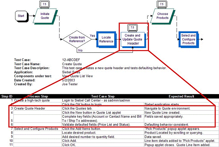

Functional test cases. Functional test cases are designed to validate that the application performs a specified business function. The majority of these test cases take the form of user or business scenarios that resemble common transactions. Testers and business users should work together to compile a list of scenarios. Following the business process testing practice, functional test cases should be derived directly from the business process, where each step of the business process is clearly represented in the test case.
For example, if the test plan objective is to validate support for the Manage Quotes Business Process, then there should be test cases specified based on the process definition. Typically, this means that each process or subprocess has one or more defined test cases and each step in the process is specified within the test case definition. The following image illustrates the concept of a process-driven test case. Considerations must also be given for negative test cases that test behaviors when unexpected actions are taken (for example, creation of a quote with a create date before the current date).
