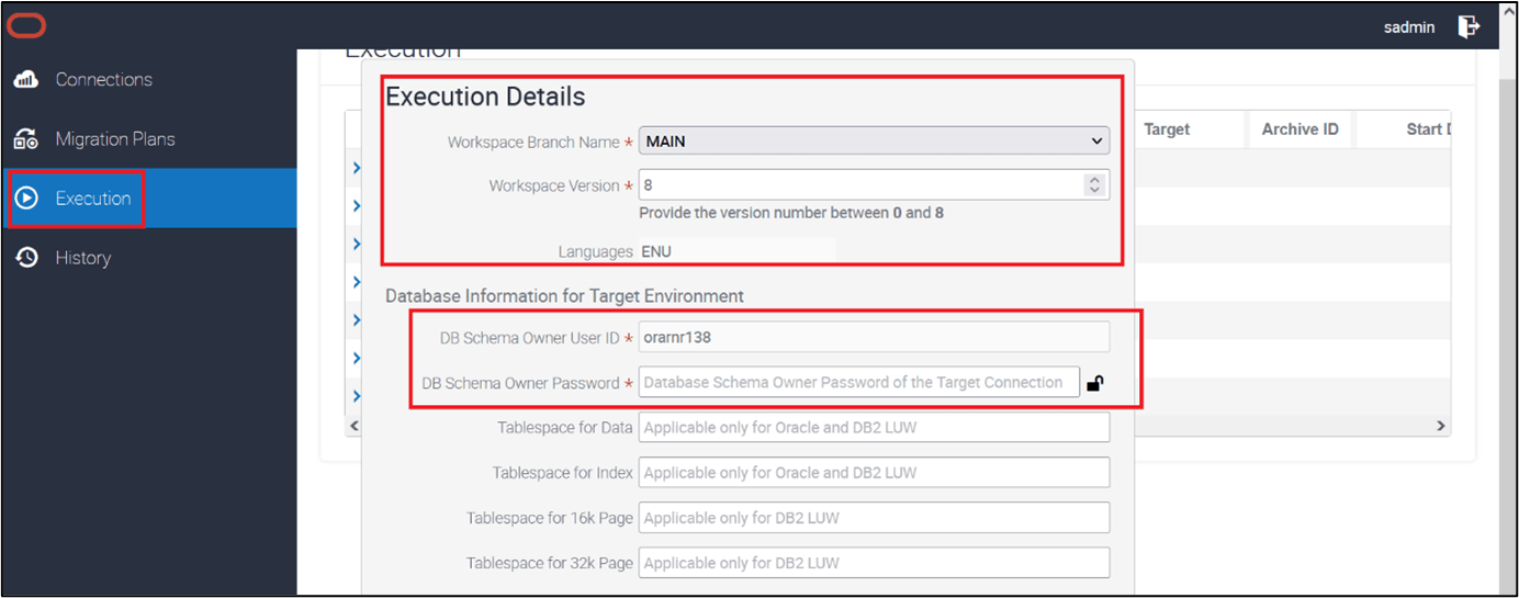

When you execute a synchronous full migration plan, the migration application prompts for the source workspace, along with the target database schema owner and password.
Full migration execution details

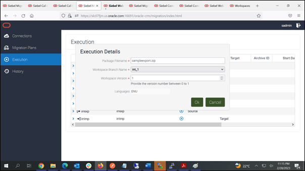

For an asynchronous full migration export job, the prompt is similar, but doesn't require the target schema owner and password, as shown in this image.
Asynchronous full migration export job details
