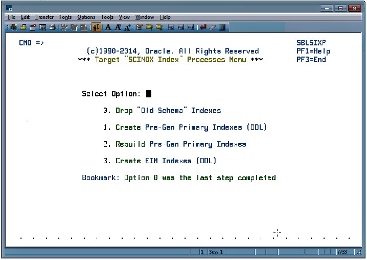

- Reselect option 9: SCINDX Index Processes, and press Enter. - The Target SCINDX Index Processes Menu is displayed. The panel ID is SBLSIXP.
- Select option 0: Drop Old Schema Indexes, and press Enter. - You are placed in edit mode on data set - DSNHLQ.SIEBEL.INSTALL.JCL(GPDRPIX).

- On the Target SCINDX Index Processes Menu, select option 1: Create Pre-Gen Primary Indexes (DDL), and press Enter. - You are placed in edit mode on data set - DSNHLQ.SIEBEL.INSTALL.JCL(GPRIX).

- On the Target SCINDX Index Processes Menu, select option 2: Rebuild Pre-Gen Primary Indexes (DDL), and press Enter. This job rebuilds the Pre-Gen primary indexes to create ROW_IDs for the data in the existing row. - You are placed in edit mode on data set - DSNHLQ.SIEBEL.INSTALL.JCL(SUBGPPIX).

- On the Target SCINDX Index Processes Menu, select option 3: Create EIM Indexes (DDL), and press Enter. - You are placed in edit mode on data set - DSNHLQ.SIEBEL.INSTALL.JCL(EIMIX).
