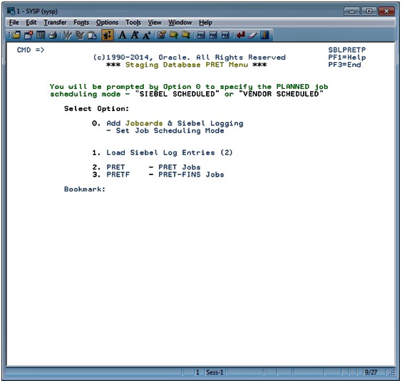

  1. On the Staging Database File Generation Menu select option 4: PRET Processes. The Staging Database PRET Menu is displayed. The panel ID is SBLPRETP.
    The Staging Database PRET Menu options are: 0. Add Jobcards and Siebel Logging - Set Job Scheduling Mode, 1. Load Siebel Log Entries (2), 2. PRET - PRET Jobs, 3. PRETF - PRET-FINS Jobs.
  2. To build job cards for the PRET and pretfins job types, on the Staging Database PRET menu, select option 0: Add Jobcards & Siebel Logging, and press Enter.
