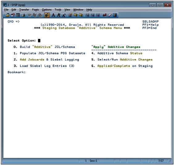

- On the Staging Database File Generation Menu, select option 3: Process Additive Components, and press Enter. - The Staging Database Additive Schema Menu is displayed. The panel ID is SBLSADMP.
- Select option 0: Build Additive JCL/Schema, and press Enter, - Status messages are displayed as the additive components are built.
- On the Staging Database Additive Schema Menu, select option 1: Populate JCL/Schema PDS Datasets, and press Enter.

- On the Staging Database Additive Schema Menu, select option 2: Add Jobcards & Siebel Logging, and press Enter. - A message appears, asking you to confirm that the - DSNHLQ.SIEBEL.PROC(ISPBAT)(ISPF batch procedure) is correctly configured.
- Verify that the ISPF batch procedure, - dsnhlq.siebel.proc(ispbat), is modified to your installation standards, then enter Y to confirm and press Enter.

- On the Staging Database Additive Schema Menu, select option 3: Load Siebel Log Entries (3), and press Enter. This option runs the job to load the Siebel logging table with additive entries for staging jobs.

- On the Staging Database Additive Schema Menu, select option 4: Additive Schema Status, and press Enter. - The Additive Schema Status panel is displayed. The panel ID is SBLSADLP. A list of the additive schema members is displayed and their staging status, either PENDING or COMPLETED.
