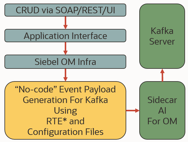

Option 1: Publish with configuration only, without writing any custom code. The following represents conceptual data flow for a No-Code/1-Step Publish:
Following are the configurations required:
Create a business service based on CSSEAIEventHandler or its subclass.
Create RTE with Action Set as follows:
Attribute Value Action Type
Business Service
Business Service Name
MyDerivedAccountEvtPubSub
Business Service Method
SendEvent
Configure eventpayloadconfig.txt, which involves adding entries in the eventpayloadconfig.txt file for the business components and fields whose data then get posted to Kafka. See Configuration Files for Payload Generation
Note: Siebel pre-delete record RTE is supported only for synchronous (or 1-Step) payload transmission to Kafka.-

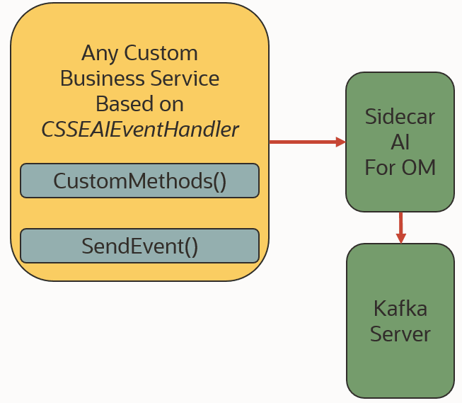

Option 2: Send bespoke content to Kafka by implementing custom business logic.
The following represents conceptual data flow for publishing any desired content to Kafka from custom implementation:
Create Business Service based on CSSEAIEventHandler or its subclass.
Generate custom payload inside the custom business service created in the last step.
Invoke SendEvent method.
Note: In this option, you do not need to configure eventpayloadconfig.txt.-
