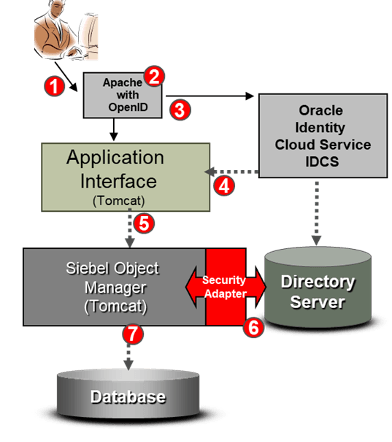

The following figure describes the architecture for Siebel CRM integration with IDCS.
The Siebel CRM integration with IDCS architecture has this workflow:
Siebel CRM integration with IDCS architecture workflow
  1. User tries to access the application.
  2. The Apache reverse proxy with Open ID module intercepts the request (HTTPS / HTTP).
  3. OpenID checks for the existence of a session cookie on the user’s computer. If a valid cookie exists, then the OpenID populates the header variable and the UserID is passed to Siebel.
  4. If no cookie exists, then the user is prompted for credentials using the IDCS form. The user enters the credentials which are passed to the Identity Cloud Service.
  5. If the credentials are authenticated, then the IDCS session cookie is set and the OpenID sets the header variable and redirects the request to Siebel.
  6. Siebel security adapter retrieves the database account and role information from the directory server.
  7. Siebel session is started with the appropriate responsibilities.
