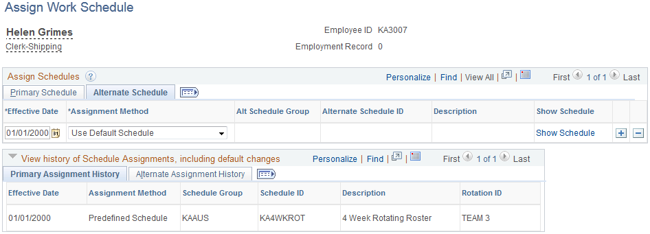

Alternate Schedule Tab
Select the Alternate Details tab.
This example illustrates the fields and controls on the Assign Work Schedule page: Alternate Schedule tab.
Use this tab to assign an alternate schedule to a payee. The fields on this tab are similar to the fields on the Primary Details tab.
Viewing the History of Schedule Assignments
When you click the link to expand the history section of the page, the system displays all of the schedule assignments, including any changes to the default schedule assigned to the payee's pay group.
