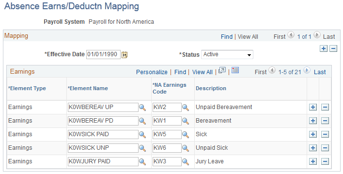

Mapping Absence Management Codes to Payroll for North America without Time and Labor
Access the Absence Earnings/Deduction Mapping page using Payroll for North America as the payroll system .
This example illustrates the fields and controls on the Absence Earns/Deductn Mapping page for Payroll for North America without Time and Labor.
Use this page to map earning elements in Absence Management to Earning Codes in a Payroll for North America system that does not interface with Time and Labor.
Note: All positive input generated in Absence Management that interfaces directly with Payroll for North America without Time and Labor must be linked to earning codes on the Absence Earnings/Deduction Mapping page. Earning codes for Payroll for North America originate from the Payroll for North America Earnings Code table.

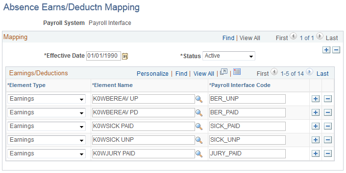

Mapping Absence Management Codes to Payroll Interface
Access the Absence Earnings/Deduction Mapping page using Payroll Interface as the payroll system .
This example illustrates the fields and controls on the Absence Earns/Deductn Mapping page for Payroll Interface.
For Payroll Interface, you can map both earning and deduction elements from Absence Management.
Note: Positive input generated in Absence Management does not need to be mapped to valid Payroll Interface codes. Absence Management does not validate Payroll Interface codes. Mapped Payroll Interface codes are free form, as defined by the third-party payroll system's interface. Element numbers (PIN_NUM), Element Codes (PIN_CODE) or Element Names (PIN_NM) can be used instead of mapped Payroll Interface codes to identify Absence codes in Absence Management's output interface file.
