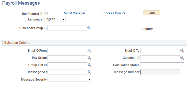

Use the Payroll Messages page (GP_GPSQR04_PNL) to run the Messages Report (GP000004) SQR process to identify payees who may need further editing to make it through finalization of the payroll.
Navigation:
This example illustrates the fields and controls on the Payroll Messages page.
Field or Control |
Description |
Calendar Group ID |
The calendar group to process. |
EmplID From and EmplID To |
Range of payees to process. Do not enter an EmplID To value without also entering and EmplID From value. |
Pay Group |
The pay group to process. |
Calendar ID |
The calendar to process. |
Group List ID |
Payees currently assigned to the group list ID will be processed. |
Calculation Status |
Calculation status to process. |
Message Set |
A specific message set can be selected, and the system will report only those messages in Absence Management. |
Message Number |
This field is available if you select a message set. Enter any valid message number. |
Message Severity |
Select Error or Warning to exclude informational messages and process terminating errors (message numbers under 300) from the report. |
