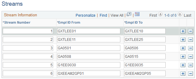

Use the Streams page (GP_STREAM) to set up a processing stream.
Before you can use stream processing, you must partition tables in the database.
Navigation:
This example illustrates the fields and controls on the Streams page.
Enter a stream number and the EmplIDs of the first and last payees to include in the stream.
Note: You cannot include the same EmplID in more than one stream.
