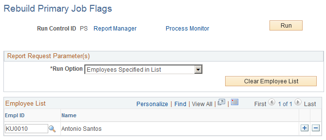

Use the Rebuild Primary Job Flags page (RUNCTL_BEN500) to automatically build primary job information for multiple employees.
Navigation:
This example illustrates the fields and controls on the Rebuild Primary Job Flags page. You can find definitions for the fields and controls later on this page.
When the utility runs, it deletes all existing data for the indicated employee population (if any) in the Primary Jobs Table. For each employee, the utility makes a new effective-dated entry, assigning the primary job designation to the lowest active employee record within a benefit record number. Primary job information is created for a time span bounded by the earliest and latest job effective dates for all jobs within a benefit record. If all jobs within a benefit record are terminated, the job with the lowest employee record is designated as the primary job.
Warning! All manual changes made through the Maintain Flags page for the selected employee population are lost, because the complete primary job history is rebuilt for each employee.
| Field or Control | Description |
| Run Option | Specify which employees to process: Employees Specified in List: Enter one or more employee IDs in the Employee List group box. All Employees in the Database: Select to specify that all employees in the Personal Data Table be processed. Employees in a PS Table: Enter the name of any PeopleSoft table that is defined in the Application Designer and contains an Employee ID field. Employees in a non-PS Table: Enter the name of a non-PeopleSoft table that contains an Employee ID field. |
