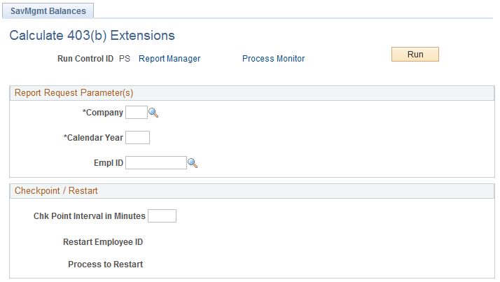

Use the Calculate 403(b) Extensions page (RUNCTL_SV403B) to calculate the company's or an individual employee's balances for service years, eligible earnings, and projected limits for the current or next year.
Employees don't need to be enrolled in the 403(b) Savings Plan to run the Balance process. This process updates the Savings Management page.

This example illustrates the fields and controls on the Calculate 403(b) Extensions page. You can find definitions for the fields and controls later on this page.
Field or Control |
Description |
Chk Point Interval in Minutes (check point interval in minutes) |
Because this is a long process, you can indicate how often the system should save or update information to the database during the process. In case of unexpected system failure, this could limit the amount of reprocessing that the system would have to repeat. |
Restart Employee ID and Process to Restart |
The system enters the last successful employee ID processed if the process did not successfully finish. |
