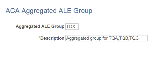

Use the ACA Aggregated ALE Group page (ACA_ALE_GRP) to create an Aggregated ALE Group. To identify which ALE Members belong to an Aggregated ALE Group, an ACA Aggregated ALE Group Table is delivered.
Navigation:
This example illustrates the fields and controls on the ACA Aggregated ALE Group page.

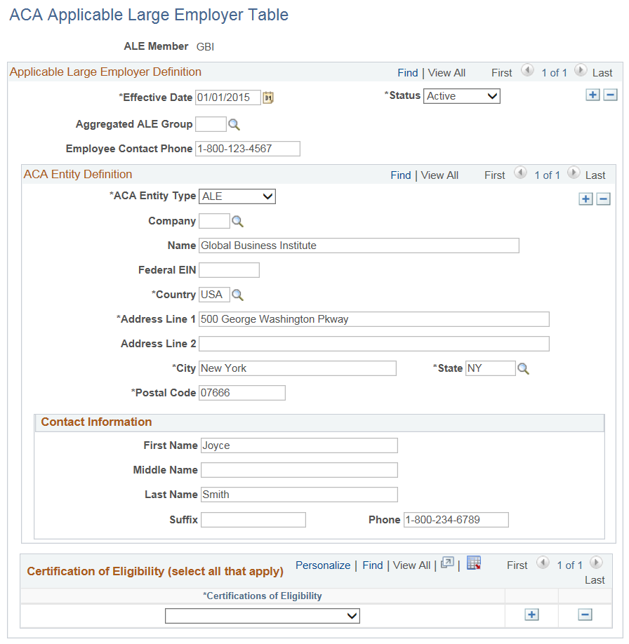

Use the ACA Applicable Large Employer Table page (ACA_ALE_TBL) to add a Company that is identified as an ALE (Applicable Large Employer) Member. There must be a valid entry in the ACA Applicable Large Employer Table for each employer that will use the employee consent process to provide Form 1095-C electronically. An entry can be added to the ACA Applicable Large Employer Table only for a Company that is identified as an ALE Member.
Navigation:
This example illustrates the fields and controls on the ACA Applicable Large Employer Table page. You can find definitions for the fields and controls later on this page.
Field or Control |
Description |
ALE Member |
Applicable Large Employer Member is a single person or entity that is associated to Form 1094-C Reporting. Can be associated with one Company or group of Companies that share the same EIN. |
Aggregated ALE Group |
If the ALE Member is a member of an Aggregated ALE Group, the Aggregated ALE Group ID will be added here. Otherwise, blank. |
Employee Contact Phone |
This phone number will appear on the contact phone of Form 1095-C. |
ACA Entity Type |
‘ALE’ for ALE Member information. ‘DGE’ for Designated Governmental Entity information. Each ALE Member must have a business name, Federal EIN, address and contact information under ACA Entity Type ‘ALE’. If a Designated Governmental Entity is filing on behalf of a Governmental Unit, the Governmental Unit is an ALE Member and the Designated Governmental Entity information is entered under ACA Entity Type ‘DGE’. |
Same as Company/Agency Table |
If the Federal EIN and address of the ALE Member or Designated Governmental Entity is the same as in the Company Table, enter the Company here. The Company information from the Company Table will be populated onto the lines below and the fields will become display only. Otherwise, these fields can be entered manually. |
Name |
Employer’s name. |
Federal EIN |
9-digits including dash. |
Country |
Look up from Country Table. |
Address |
Employer’s complete address including address, city, state, and postal code. |
Contact Information |
Contact First Name, Middle Name, Last Name, Suffix and Phone are used on the Employer Form 1094-C transmittal file. |
Certification of Eligibility |
Enter all the applicable Certifications that the ALE Member applied for. This information will be included on the Employer Form 1094-C transmittal file. |

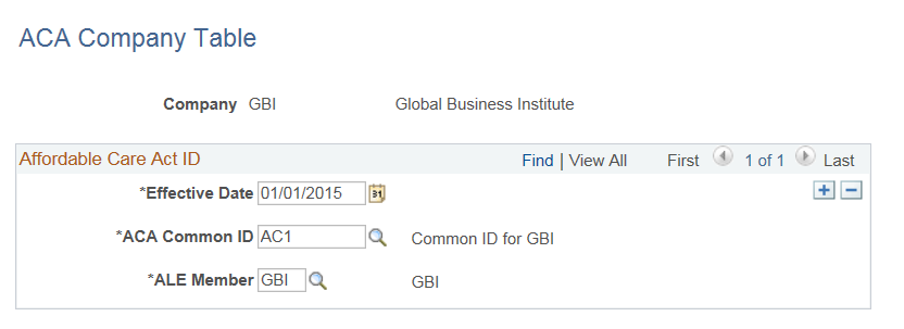

Use the ACA Company Table page (ACA_CMPY_TBL) to associate an ALE Member to a Company. Multiple Companies can be associated to same ALE Member if they all share the same EIN.
Navigation:
This example illustrates the fields and controls on the ACA Company Table page. You can find definitions for the fields and controls later on this page.
Field or Control |
Description |
ALE Member |
Enter Applicable Large Employer Member that is associated with Company. |

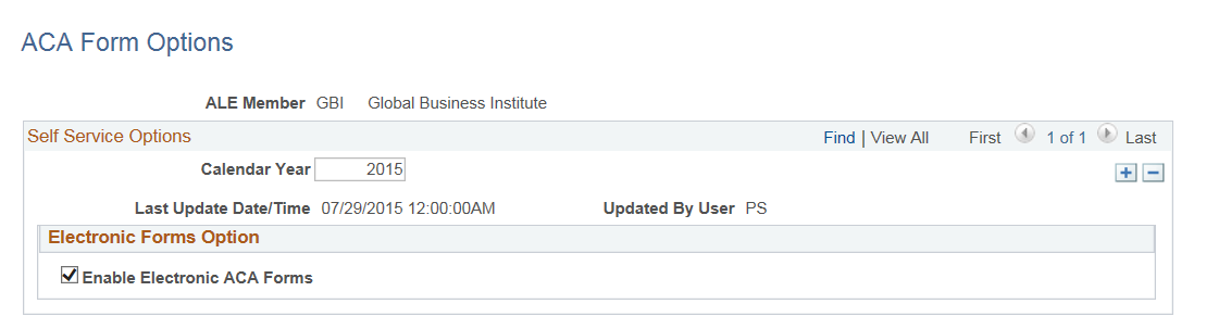

Use the ACA Form Options page (ACA_FORM_OPTS) to enable the electronic option for Form 1095-C. This step is required to enable employees to grant consent to receive electronic forms.
Navigation:
This example illustrates the fields and controls on the ACA Form Options page. You can find definitions for the fields and controls later on this page.
Field or Control |
Description |
Calendar Year |
Create a new row each tax year. |
Enable Electronic ACA Forms |
Select this check box to enable the ALE Member to provide XMLP PDF forms in the eBenefits Self Service transaction. If this check box is not selected, employees cannot request or withdraw consent or view Form 1095-C. After employees have granted/withdrawn consent, an administrator can disable this option by deselecting this check box and running the Reset 1095-C Consent Status process. |
