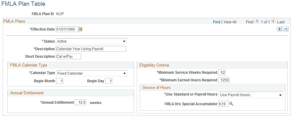

Use the FMLA Plan Table page (FMLA_PLAN_TBL) to enter FMLA plan details.
Navigation:
This example illustrates the fields and controls on the FMLA Plan Table page. You can find definitions for the fields and controls later on this page.

Calendar Type |
Employees who are eligible for FMLA-protected leave are entitled to at least 12 weeks of leave during each 12–month FMLA year. Three different ways are available to define the FMLA year: Fixed Calendar: Defines a 12–month period with a specific starting date (defined with the Begin Month and Begin Day fields). It can be the calendar year, fiscal year, or a 12–month period that is defined by state law. Employees with Fixed Calendar FMLA leave plans are entitled to the defined annual entitlement, less any FMLA-protected leave taken in the current fixed calendar year. The eligibility weeks for an FMLA request that is made using a fixed calendar year are reduced according to the date that the request is made. Roll-Forward: Begins the FMLA year when employees take an FMLA-protected leave and ends 12 months later. Employees' next FMLA year begins with the first FMLA-protected leave they take after the first 12-month FMLA year has passed. Roll-Backward: Counts the FMLA year backwards for 12 months from the time that employees take FMLA protected leave. If employees have taken FMLA leave in the year previous to their scheduled FMLA leave start date, that amount of leave is subtracted from their annual entitlement for the upcoming FMLA-protected leave request. |
Annual Entitlement |
Defines the number of weeks of FMLA-protected leave that employees are entitled to every FMLA year. You can define an entitlement of more than the government-mandated 12 weeks, but not less. |
Minimum Service Weeks Required and Minimum Earned Hours Required |
Use to define the length of service requirements that must be met before an employee is eligible for FMLA coverage. According to the standards set by the FMLA, the values for these fields cannot be greater than 52 weeks (12 months) and 1,250 hours, respectively. Working any portion of a week counts as a full week of employment, which enables part-time and seasonal employees to meet this requirement. The weeks of employment are also not required to be consecutive, which means that employees who are rehired after a gap in employment may still meet this requirement. The Earned Hours Required field enables the definition of a specific number of hours (up to 1,250) that an employee must have worked for the company during the previous 52 weeks to qualify for FMLA coverage. |
Use Standard or Payroll Hours |
