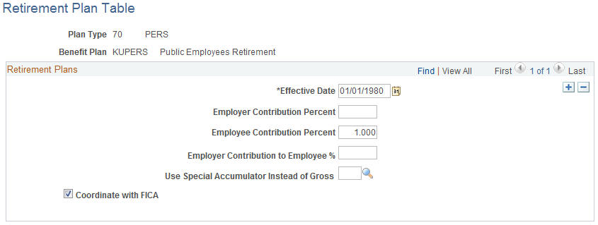

Use the Retirement Plan Table page (RTRMNT_PLAN_TABLE) to set up California PERS or U.S. federal government retirement plans.
Navigation:
This example illustrates the fields and controls on the Retirement Plan Table page. You can find definitions for the fields and controls later on this page.

Employer Contribution to Employee % (employer contribution to employee percentage) |
Define how much the employer contributes to the employee's total contribution percentage. |
Use Special Accumulator Instead of Gross |
To have the system use a special accumulator instead of the total gross, enter the desired accumulator code here. To use a special accumulator, work with your payroll department to define the code and its detail. You can set up special accumulators—as many as you need—to process savings, retirement, and pension plans. |
