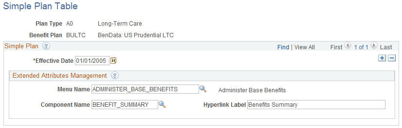

Use the Simple Plan Table page (SIMPLE_PLAN_TABLE) to define simple benefits that have no participation attributes and are rate-driven.
Navigation:
This example illustrates the fields and controls on the Simple Plan Table page. You can find definitions for the fields and controls later on this page.
Extended Attributes Management
Complete this group box if you want to collect optional extended information about enrollments in this plan. Select a menu name and component name.
If you want to override the label that is supplied by default from the component definition, enter an optional link label.
If you define an extended attributes component, the component link appears on the Base Benefits enrollment page. This enables you to navigate to the component and enter additional information for the employee.
